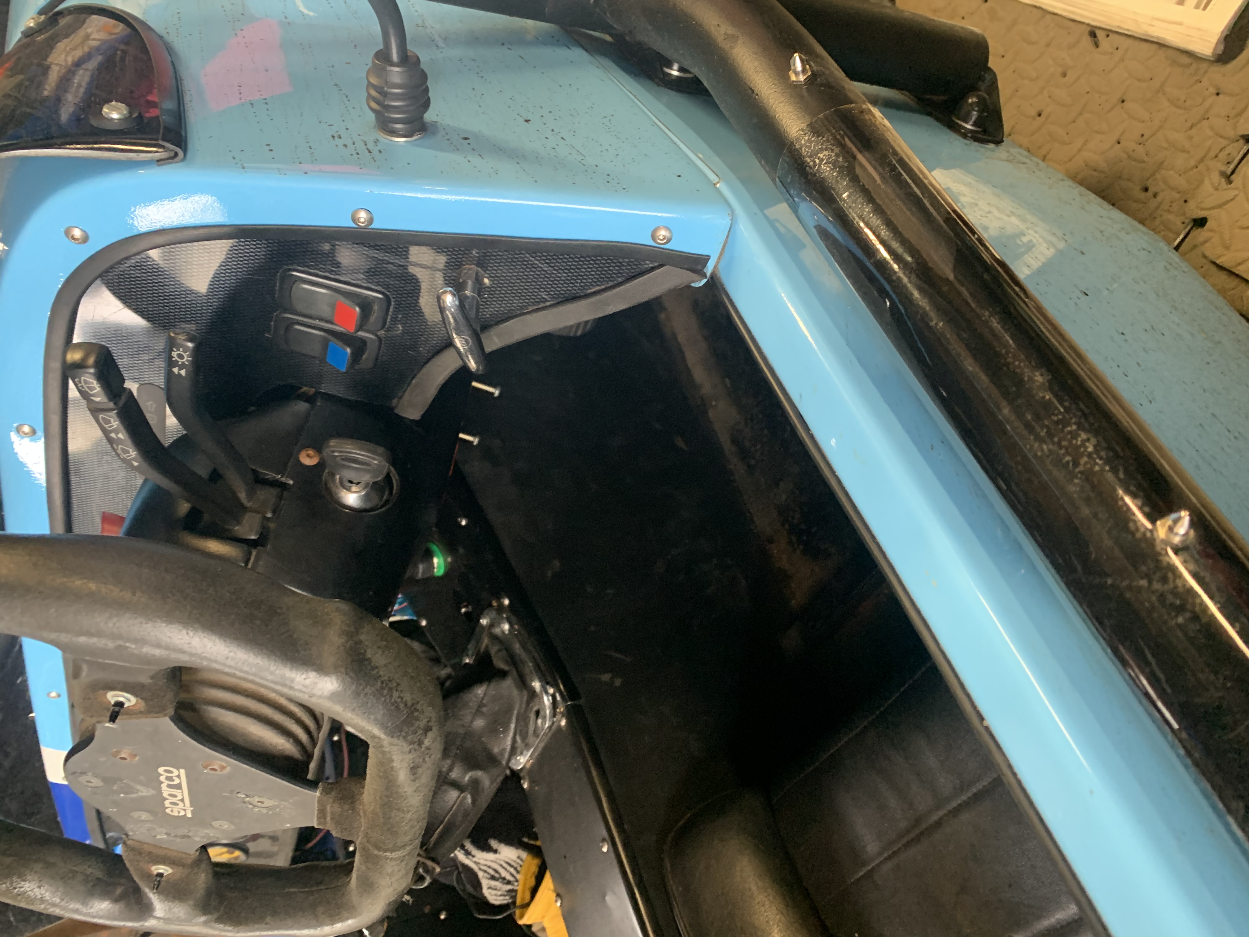

Was quite pleased to get Eleanor out on a run last weekend, seems bad to have both these kit cars up and running, taxed, mot and insured and not doing any miles.
Was pretty good run to blow away the cobwebs starting at Newlands corner with 4 others, 80 miles to Brighton.
On the way back I decided to try the crash helmet on as windchill was still pretty bad and got to say pretty impressed.
Spot of luck in the fact the car waited till I was home before all the power disappeared due to a dodgy ignition switch so after a bit of knee steering whilst holding the key just so I docked the car in the garage and later set about confirming the back of the ignition lock being the culprit.
Bit if searching the world’s favourite on line shop and a suitable one arrived just before this weekend.
Now I did try one of my fantastic video to enthrall you all but you tube seems to not like it.
So as per the pics may show I managed to take the back of the key switch off via the two grub screws (after removing the cowling ) and unplug the multi plug, as the wires on the back of the new one were too short and the wrong plug I had to cut and shut my original loom on with soldering and heat shrink before a reassuring test fire and final reassemble ready for her next adventure.
