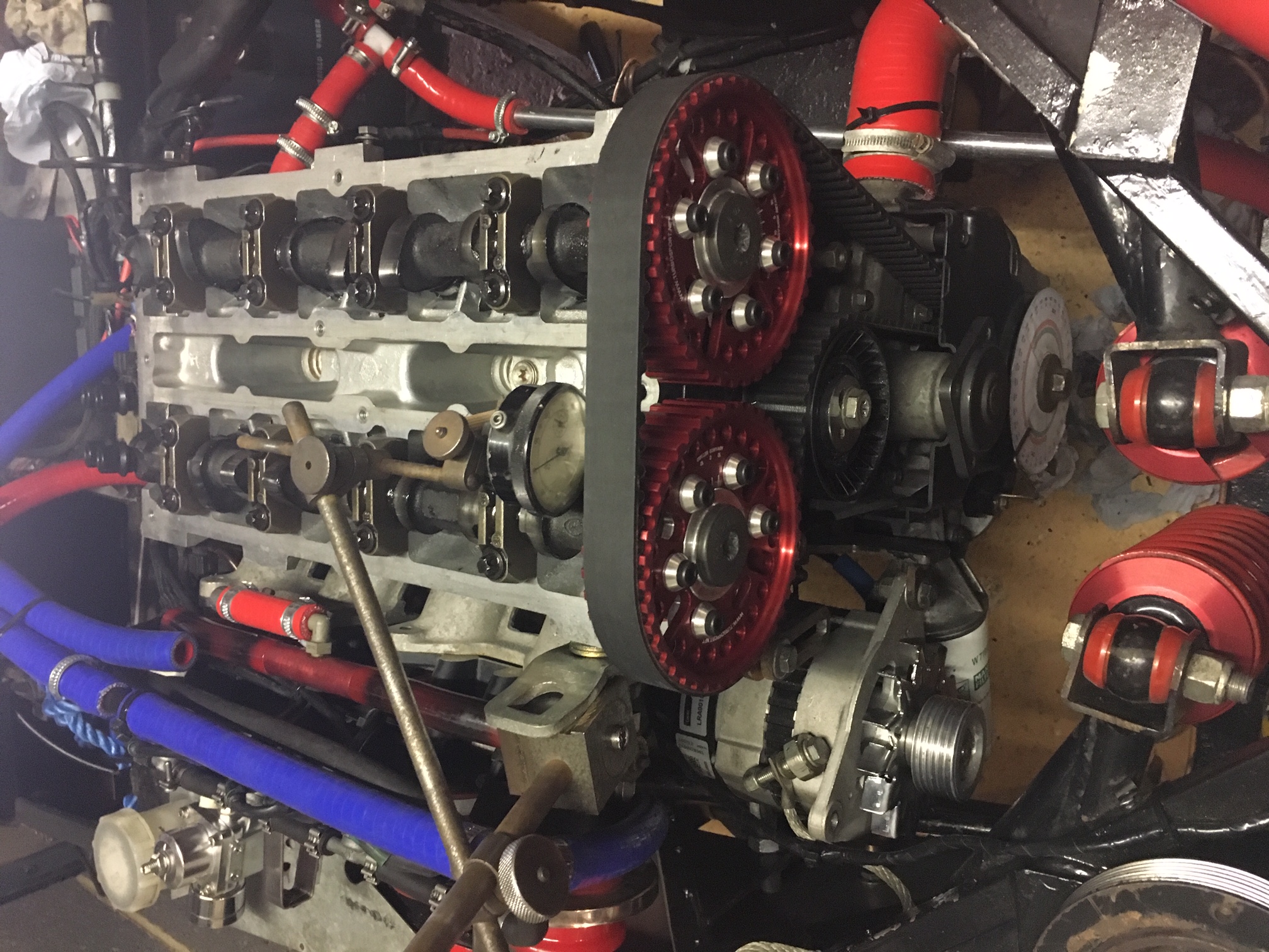

Some piccies of the rebuild ...
Vernier pulleys from Turbosport, good quality but came missing one bolt and collet (you can see in the photo). Called next day, very apologetic and posted out straight away, so would recommend if anyone is looking, about the cheapest around too.
Fired up on the 3rd turn so happy bunny!
Shiny head :)
you can see the CD protractor on the crank
shiny pistons too
cams in, used Graphogen during assembly, great stuff.
dialling the cams
ready to fire up ...
