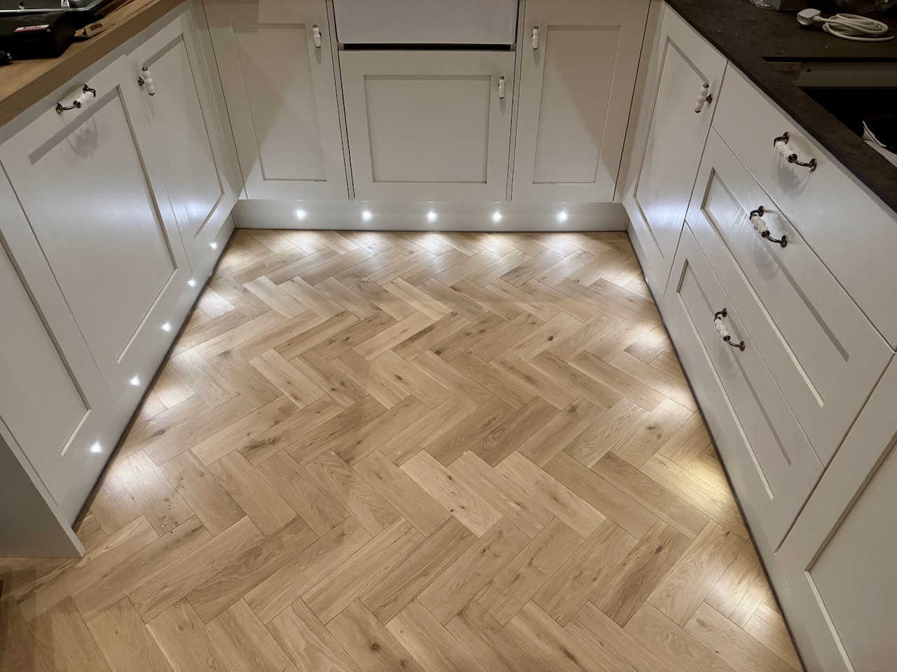

A quick update with lots of fiddly jobs done to get the kitchen finished.
All plumbed and wired in, though connections still need to be made at the other end. Installed a couple of double sockets under the breakfast bar, couldn’t bring myself to cut into the top for those pop up sockets. They looked a bit cheap and nasty tbh and too much to go wrong.
Finished around the sink and tidied up the butchered cabinet underneath. Backing panels are installed using hidden fixings, see how they go as they aren’t particularly heavy duty. If there’s no leaks etc then might add a bit of CT1 at a later date to hold the panels a little more firmly.
Had a tidy up and we’re back on the floor today.
