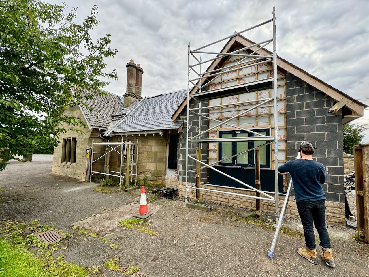

Picked James up Tuesday from Edinburgh Airport. He didn’t miss me. :lol: Straight onto the exterior cladding so we can get the outside rendered asap. Using a Eurocell product, a composite cladding with aluminium extrusion trims. It is designed for vertical installation though it’s a bit more tricky for us as we are insetting it between blockwork. We’ve also got to allow a gap for the render.
Needless to say it’s slow going using an unfamiliar system along with working off a tower. We are also doing the barge boards and soffits at the same time as they affect each other. We’ve put a window sill along the bottom to ensure rainwater goes in the right direction and the trims are raised slightly so they drain out on to the sills We’ve made a 10mm gap down the sides to allow for the rendering. The top has a 3mm gap to allow for the finishing trim so it sits tight on the soffit. We’ve worked out the planking spacing which is more or less central to the window. We couldn’t get the planks central to the space because of the ribbed profile on the back of the plank. If you don’t cut it in the right place the edges aren’t supported as the ribs need to sit on the finishing trims.
All in all a right royal pita. At least now we’ve worked it out the other gable end should be completed considerably quicker.

Started on the other gable end. All ready for the cladding after double battening and fitting the trims. Spent a bit of time helping the slater who is easing himself back into the swing of things. The roof is progressing with another pitch completed. Stripped off the last bit, once done then it’s onto the front of the lodge. There is more finished than there is to do, so hopefully the end is in sight. Stewart is a one man band, also a lovely guy and brilliant at his work. So many people have said what a great job on the roof, we are happy to support Stewart and get the job done properly even if it takes longer than having a gang throwing on the slates.
It’s not been a quick or cheap process, with James and my time taken up cutting the bullets and sorting and holing the slate but we think it is worth it especially from a quality and kerb appeal aspect.

Cladding done on the gable end. A couple of smaller areas to do next then ready for render. The slate is all done at the back of the lodge now except four slates to be done where the brackets were. Delighted with how it’s turning out. On to the front next week, which means more sorting and bullet cutting for James and I. Another local stopped by today and was full of praise for the work we were doing, which was really nice.
