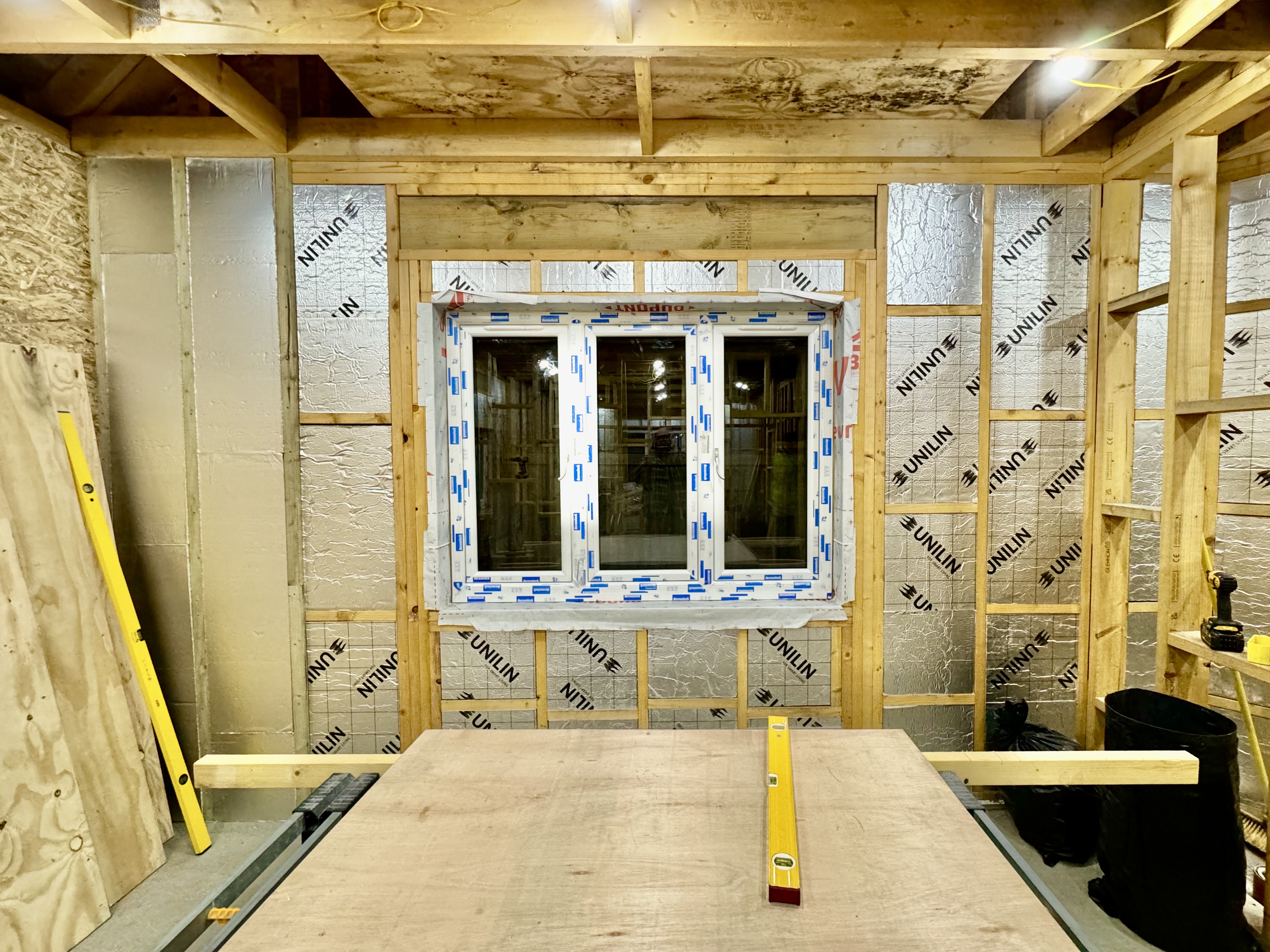

Finished the framing, other than a few adjustments for bathroom furniture fixings. Added another layer of insulation and the service voids to some of the external walls, awaiting the windows so we can finish them off once they are installed, hopefully Tuesday. Spent a day adding a few more site lights and clearing up a few odds and ends. Still had part of the temporary deck in place when we did the zinc roof so spent a bit of time cutting it out so it’s easier to route pipes etc.

A week spent mostly cutting up the new floor for shower and sink drains. We reconfigured the bathrooms, with one main bathroom and two en-suite, instead of three en-suite. We moved some doorways around which meant the main drain positions weren’t optimum, hence a bit more cutting than first planned. All cut now awaiting shower base installation then we can back fill.
Windows for the extension arrived Wednesday, so put them in the relevant holes. One left to do once we get a new cill for it. My bad.. cut and paste when ordering so ended up with the wrong width cill. Windows are nice enough, not the cheapest but not the dearest. Acoustic/laminate glass adding to the cost.
