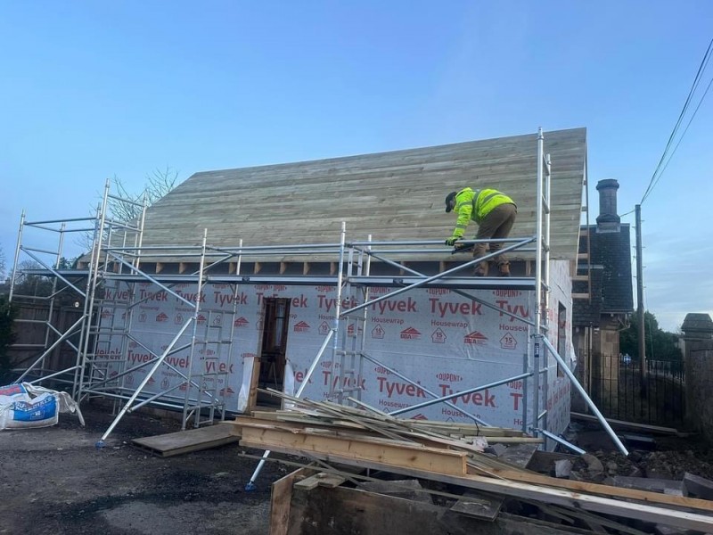

Busy week working on the roof. Long story short.. nearly there, some more fiddly bits and the gable ladders on one side then onto the sarking. A Scottish thing, sarking, basically planking on the roof instead of batterns and then felted and slates nailed directly to it. Hopefully start it on Monday. Welsh slate also turning up next week. Got a roofer on board, local guy who specialises in old buildings and slate so should do a nice job. Hoping he can start a week Monday. Will have to wait till early next year for the zinc roofer to do his bit, then the slate can be finished.
Over 5000 slate being used and it’s down to James and I to hole and dress the slate. Gonna be a cheap xmas with slate place mats and coasters for presents. (Sorry to spoil the surprise James :lol:)
Should be watertight in the next couple of weeks so looking forward to that.

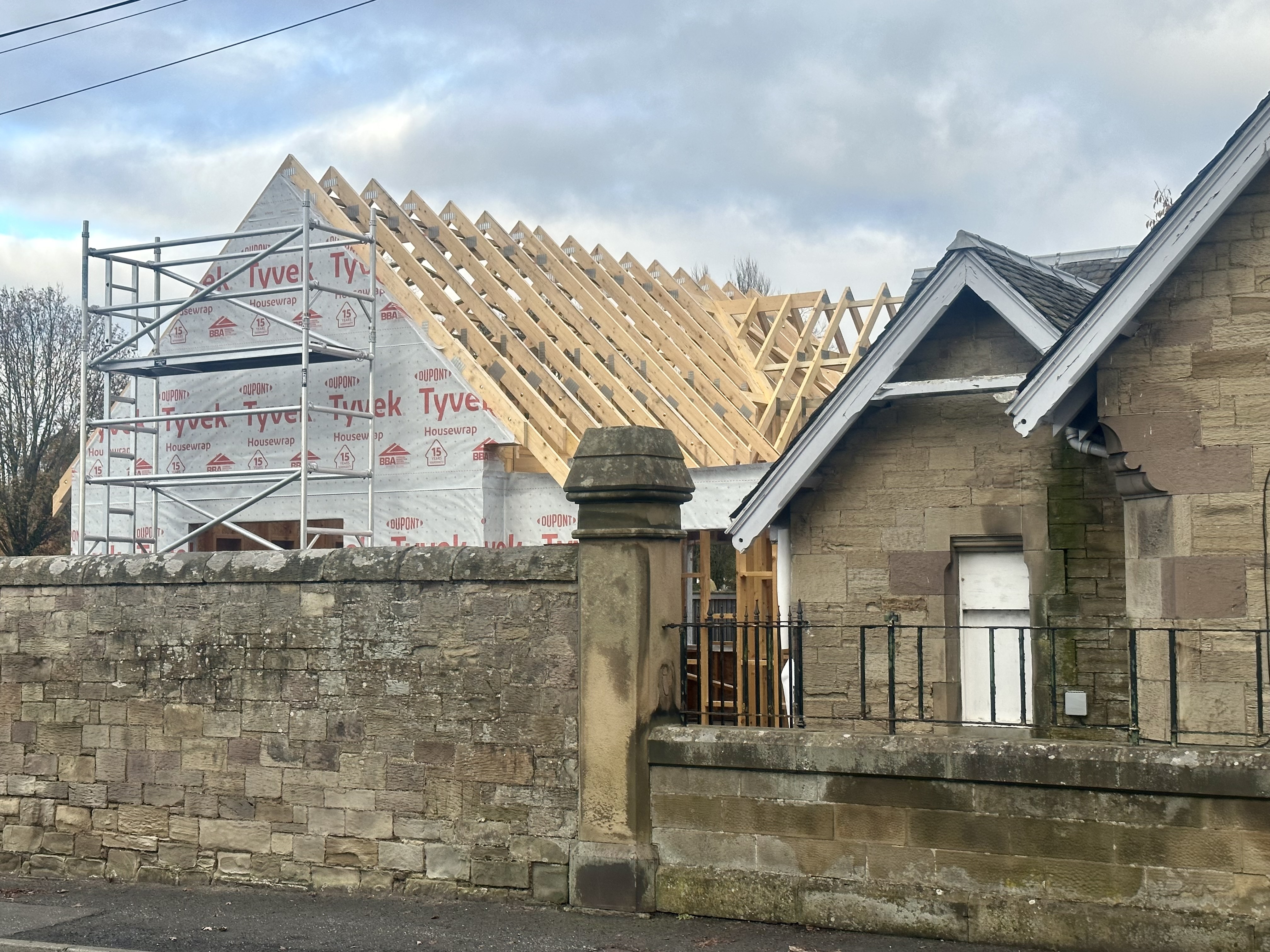

Latest progress shot as of last Friday below.

Nearly done the sarking on one side so the roofer can crack on Monday. Still got a lot of work to do on the roof to get it finished. We also need to hole and sort the slate into thick, medium and thin piles. We’re cutting some into bullets as an ode to the original roof on the lodge. Mind you if there’s a lot of waste, they’ll be going on the roof as is.
Re: Man Cave Mk2
Postby b33fy » Fri Dec 01, 2023 6:24 pm
Finished the sarking on the largest part of the roof. Still got quite a bit of work to do on the other parts of the roof. At least the roofer could make a start. Unfortunately the weather has put paid to any decent progress. James and I sorted one pallet of slate out into heavy’s, mediums and lights, along with punching the holes. Will need to sort another pallet out once the roofer has stuck a few on the roof. Hoping the cold spell eases Monday so the roofer can crack on.
