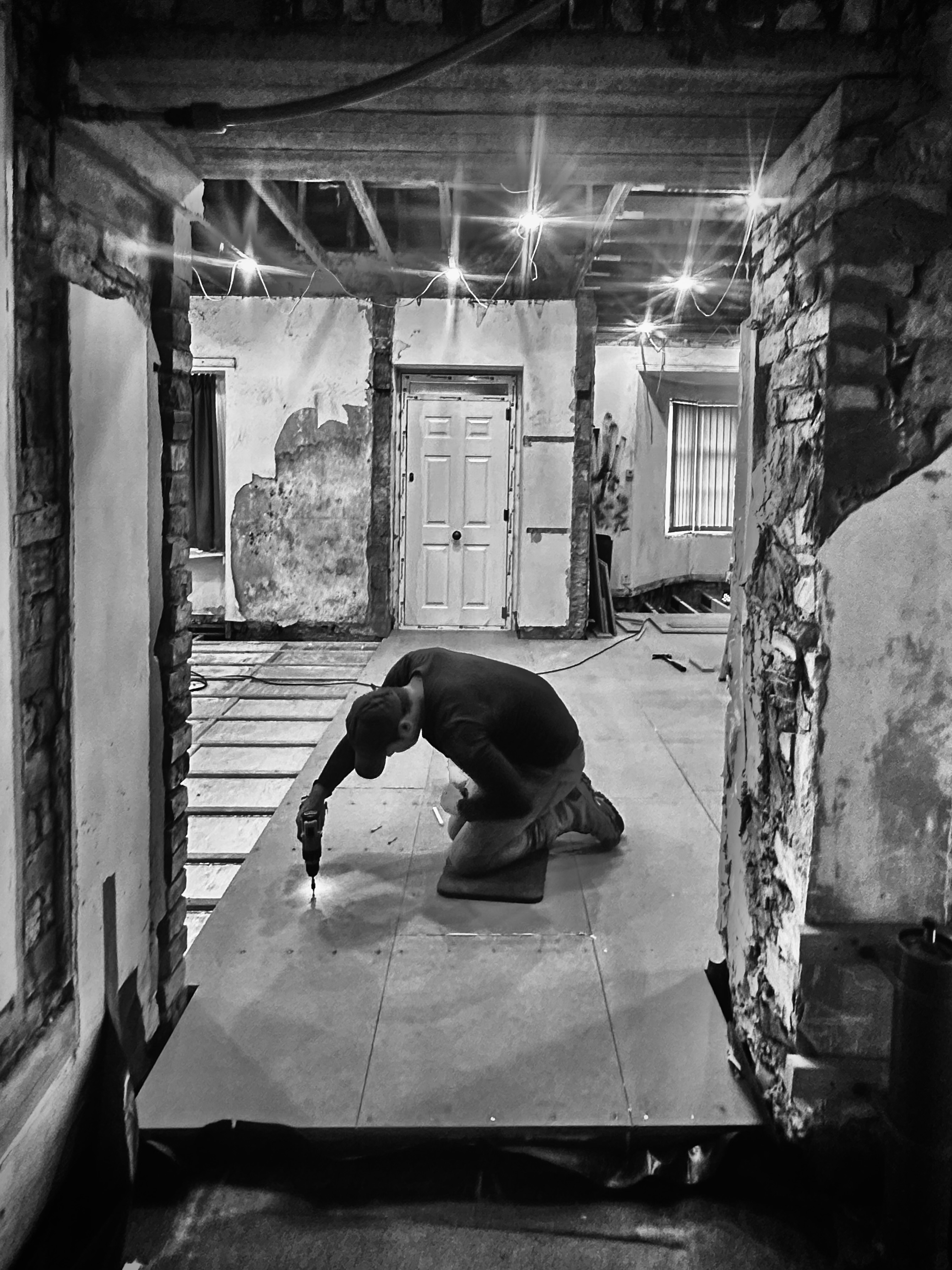

Thanks Duncan, it’s a relief to get this far tbh. Not had a massively productive week, completed a bit more flooring just to make it easier to get from the front to the back of the lodge. Also made a start on the framing with sole plates going in first. A couple of other things happening. Spent a bit of time sorting out trusses for the extension and have a company making them up off site. They have the software for structural loadings which will keep the building officer sweet. A site visit will happen soon to confirm measurements then get them constructed.
