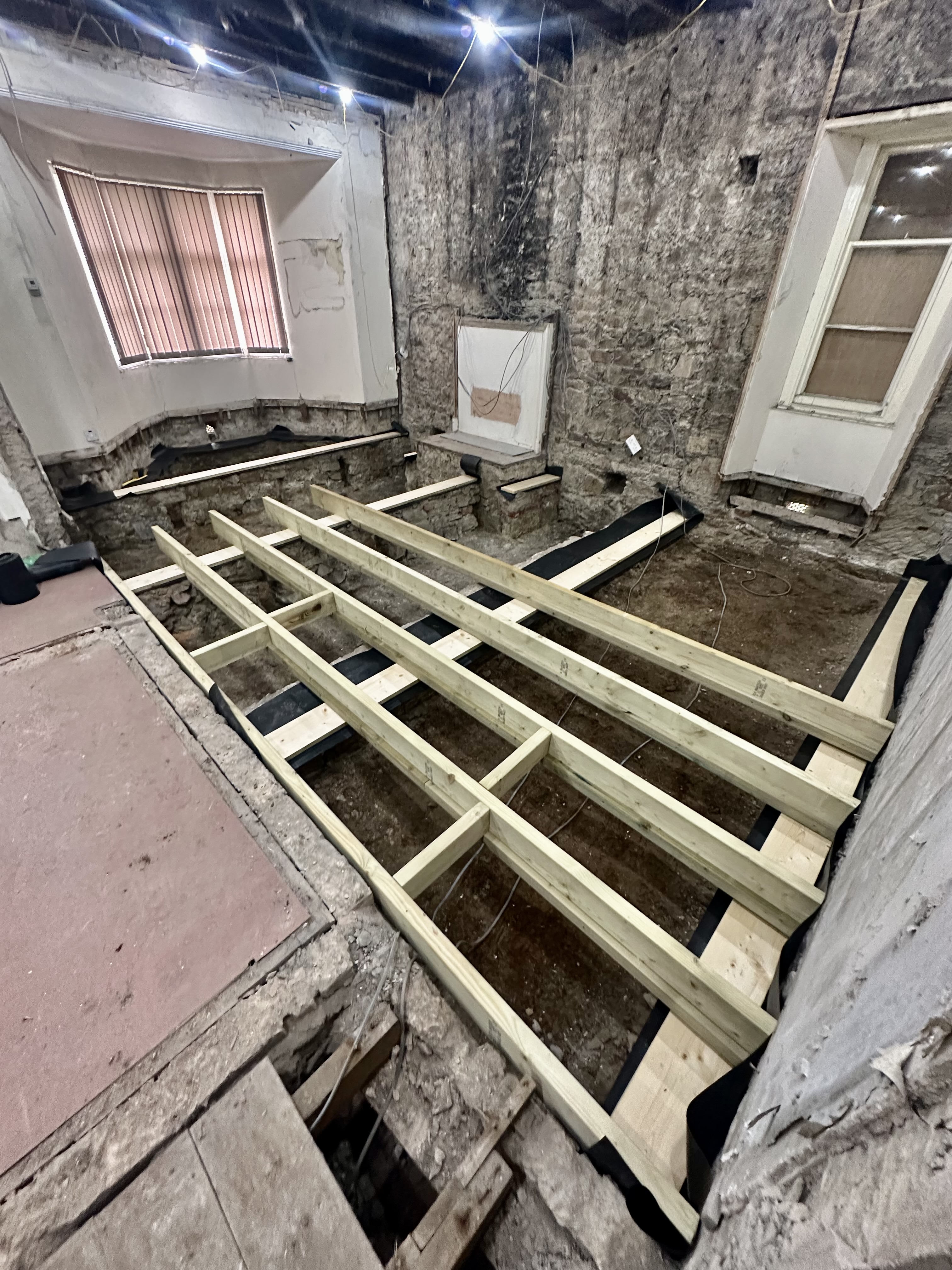

A bit more progress. Switching between inside and outside depending on weather. Footings are in, just going to start on the block work. Will give it a bit of a go but might get a pro in if too tricky. Got a block cutter to make life easier and made some bricklaying profiles to lay to so I don’t have to worry about building corners or the gauge thickness too much.

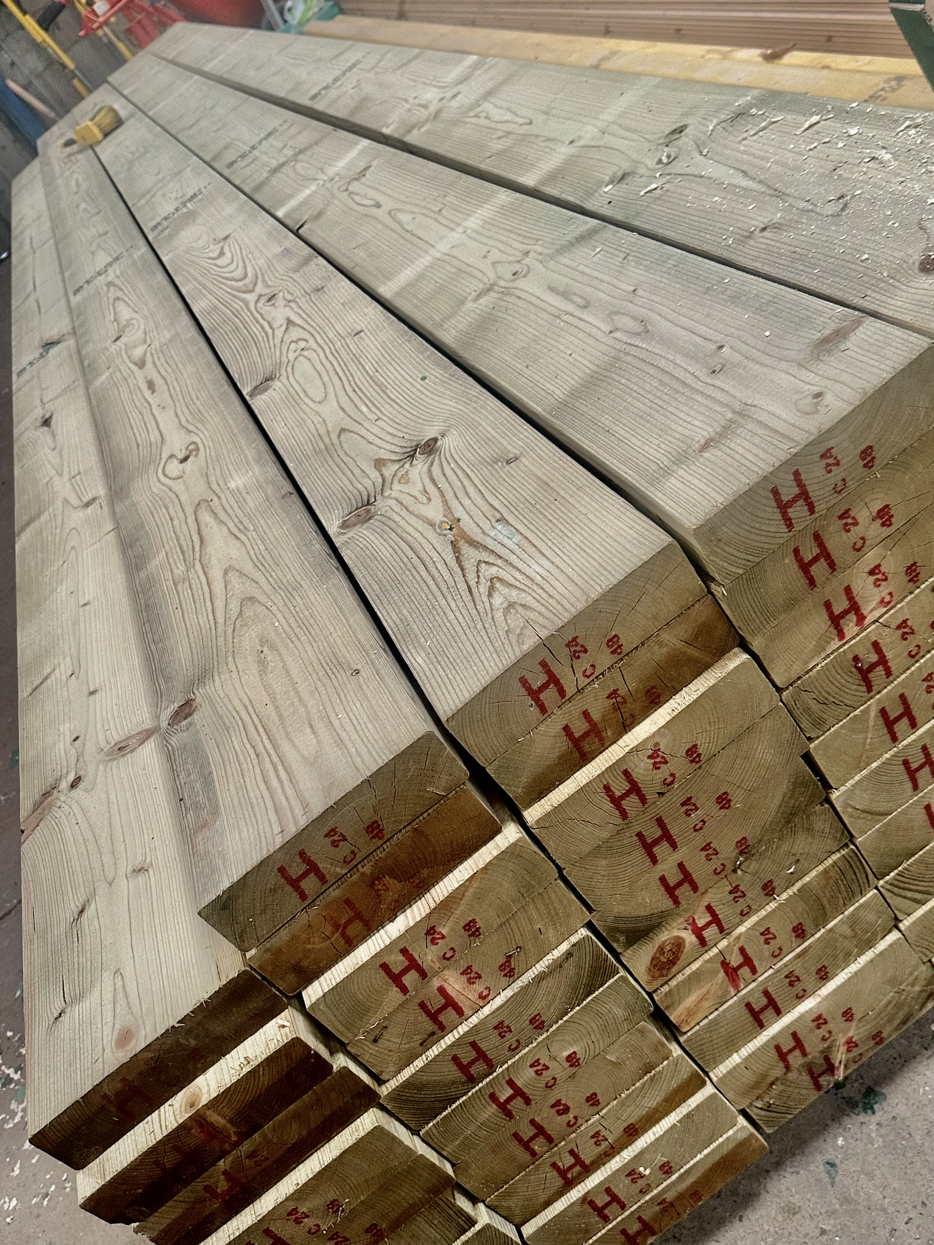

On the inside, started on ripping up some of the floor where the joists are rotten. The infill beneath the joists is high so will dig that out a bit to minimise damp along with a damp proof course under some new wall plates. Got to remove the remains of the dividing walls and put new joists across the gaps, so decided to replace all of the joists and wall plates rather than patch it in. All of the boards have to come off regardless to insulate the floor, so the only extra cost are the joists. Got a job lot of C24 coming this week at a very good price.

Woods turned up for the floor, so in poor weather we’re inside working on that. Been using a Dewalt first fix nail gun up til now which is ok, but sometimes struggles to drive in 90mm nails. It’s an electric gun which I think works on a flywheel principle. The advantages over a gas nailer is it doesn’t need gas canisters or regular cleaning and servicing and will work in all temperatures as long as it’s not too cold to recharge the lithium battery packs. It struggles with 90mm galvanised ring shank nails which are the nail of choice for constructing the new floor and general framing, so a new Paslode gas nailer has been ordered. This should smash the nails in no problem.

Floor starting to take shape. Levels are all over the place. Old floor didn’t feel too bad but wasn’t 100% level. Wall plates are on the slope and different heights so will have to pack each joist. Using the fireplace hearth as a reference point, hopefully all will be good once done.
