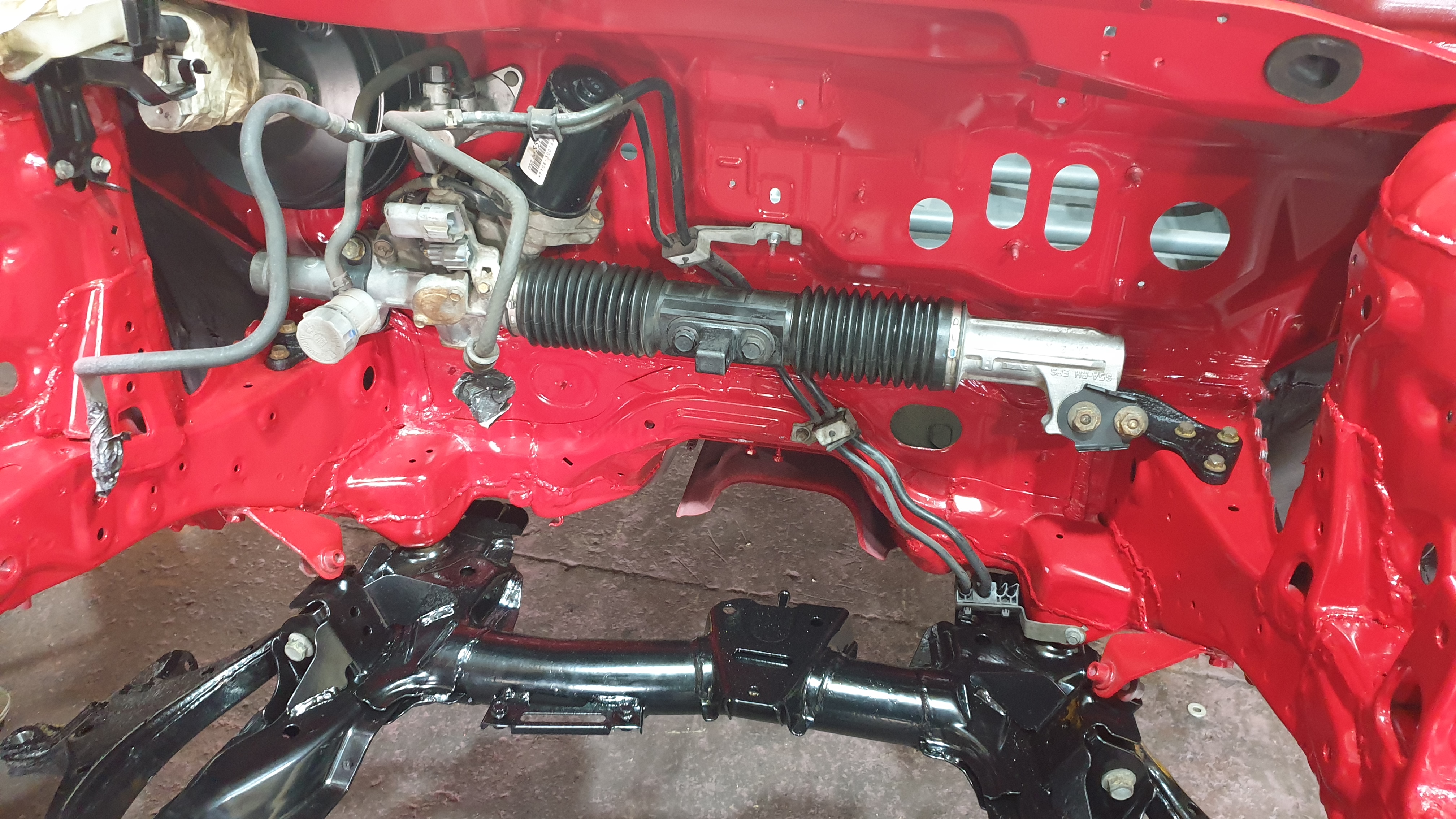

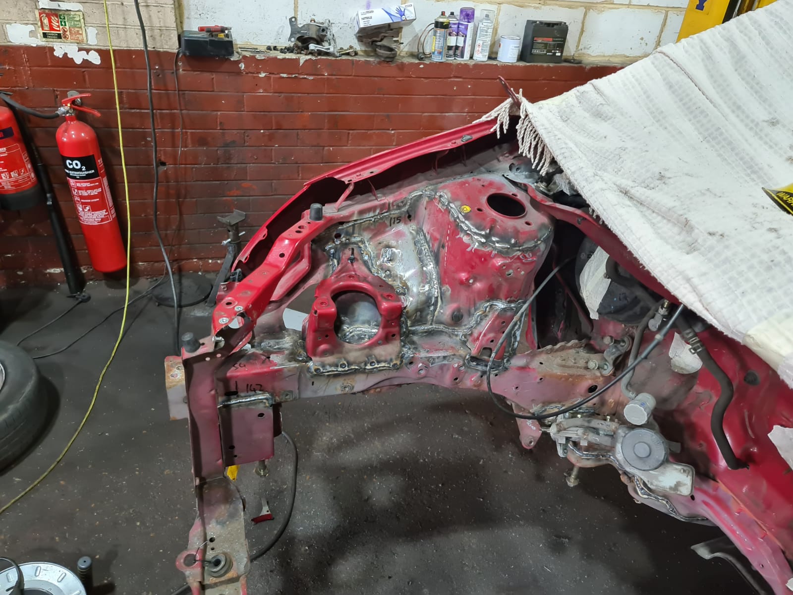

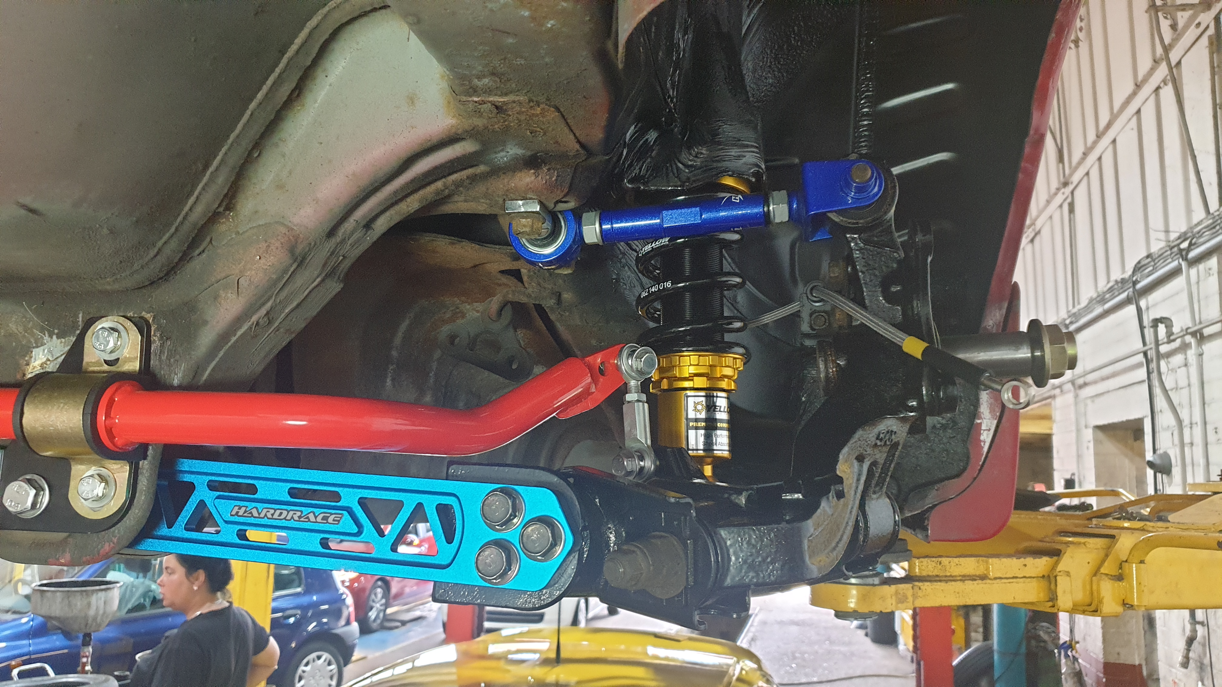

Postby Nash » Sun Sep 06, 2020 8:36 pm
Well that was a long gap between posts!!!
As the world tries to kick-start I finally got to see the car for the first time in 5 months at the end of July.
Since then progress has been made.
The shell was painted internally with the cage complete
The engine bay was rebuilt with the re-constructed mounts all seam welded in along with the rest of the bay and all painted.
The subframe and suspension arms were all powdercoated and where applicable rebushed with Spherical bearings and fitted to the shell.
The new suspension was assembled at each corner loosely.
New rear brake assemblies installed and the new front brakes ordered.
The engine and box assembly was mated once the new lightened flywheel and clutch was fitted to go with the LSD and changed final drive and fitted in the engine bay.
Engine install in progress.
Front end awaiting brakes
Rear end boxed up
Rear end coming together
Suspension installed
Rack installed
Engine bay in paint
Powdercoated subframe installed
Spherical bearings fitted
Progress
Stick it together
Pig in poop
Cage in paint
